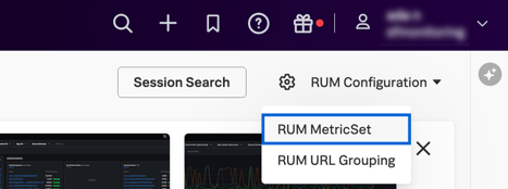

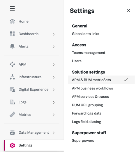

- Navigate to the MetricSets configuration page through either of these paths:
Select Digital Experience and then in the Real user monitoring section select Overview. On the Overview page, select as seen in the following screenshot.
From the left navigation menu, select
